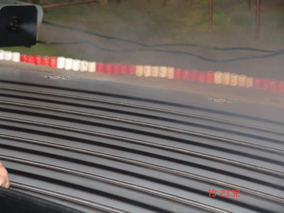

We have produced fog at night shifts at the Spa track. It was really cool to see the cars drive through a fog cloud. Does somebody have pictures of that to show here?
greetz,
Slotmad
View User's Profile E-Mail User View All Posts By User U2U Member
LMSadmin
Posts: 699
Registered: 1-1-1970
Location: Amsterdam
Mood: Dont wannabe a moderator if it starts to look like work ;)
posted on 13-12-2009 at 13:15 Reply With Quote
Foggy Spa
http://lh6.ggpht.com/_JqD5UapWank/SDrRBQUSAKI/AAAAAAAACxs/OdysZeogSUQ/s912/IMG_7127.JPG
http://lh6.ggpht.com/_o_MIH4g7bHM/SDrnZnUFI_I/AAAAAAAANOM/I16e3blHsKw/s912/eec_rnd3_147.JPG
