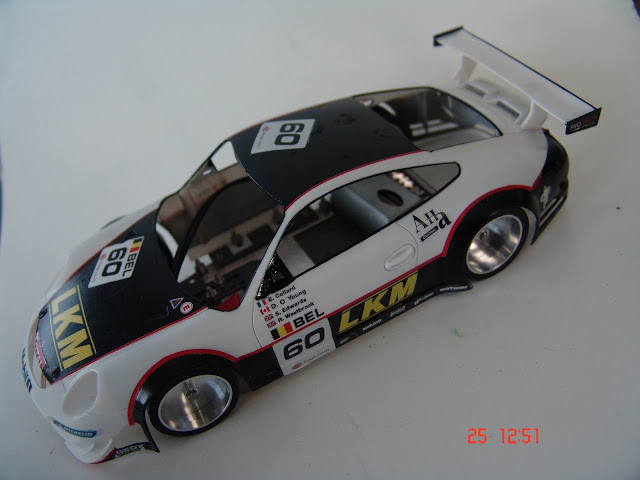

Hi Guys,
my car is alomost ready here are some pics of the work as it was in progress.----
Was a pretty straight forward build, there was a lot of info online thanks to Mark and Nick.
A shame that the bodys/kits are so hard to come by!
I built the prospeed version, as I had a decal set left over and dont really feel fantasy liveries and do not wish to be 1 of 69 fRying Wizards
Any way dismantled and sanded/ flattened the chassis parts,
Discarded the bushes and added ball bearings, ground the 2709 wheels down to the required 26,5mm, changed the guide tongue, swapped the screws, and
replaced the spur gear with a Jp44z version.

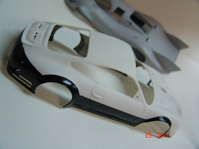

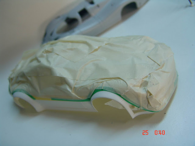

Sanded cleaned, masked the body, painted it white/black masked off the white and painted the black arts mattt clear. ....
Think the pics can tell the story better ;.)
