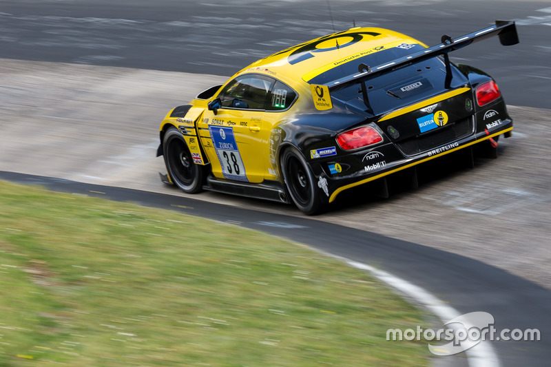

the #38 Bentley currently in 7th place also looks nice...and I've got plenty of yellow left from the C6R projects
