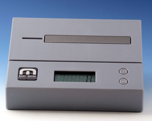

As all of the current O2 ready tracks that can host larger events have metal(lic)rails, the magnetic "down" force of the motors would be part of the equation in their suitability for the GT3 formula. Here we measured two values, the magnetic pull translated in grams on a Magnet Marshal and the ground clearance under the centre of the motor measured in mm. Why? Well first of all beacuse not everybody has a Magnet Marshal at their disposal and even if you do, calibrating them would be an issue. Secondly because, as you can see in the table below, the magnetic pull of a motor and its distance to the track rails are directly related to each other....and that relation is exponential.
Obviously the lower you get the harder it starts to pull, but if you look at the far right column (NSR Baby King) you'll see that the first decrease of GC by 0,5mm in increases the magnetic pull by 5gr, the second decrease with just 0,4mm increases the downforce by 10gr
What we were looking for was a motor that would have a similar level of downforce as a DiSCA LMP1, at a ground clearence that would keep the motor far away from the undulations of the Ninco track rails (≠1,6 mm) with a margin for the expected tyre wear. (hence 1,8mm)
