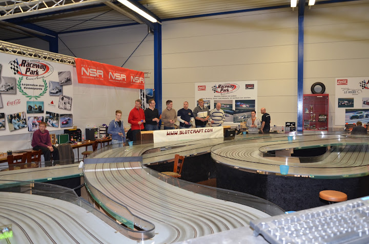

Hier een aantal impressies..
https://lh4.googleusercontent.com/-j2cRVJf7998/Ueu26y99IMI/AAAAAAAAFbg/z38U34Y9aH4/s720/IMG_9659.JPG
https://lh3.googleusercontent.com/-7ztth2SHNNU/UN7BK26x88I/AAAAAAAAWl0/d1ecdN1KyWk/s640/2012-12-28%252014.39.10.jpg
Mijn huidige Corvette
https://lh5.googleusercontent.com/-FHUSkHUxJLw/UYehGudPTsI/AAAAAAAAFHQ/95Kz9B5Y4HQ/s640/919931_4913092742089_429692945_o.jpg
https://lh6.googleusercontent.com/-4XyRKtrhnac/UYelheGldJI/AAAAAAAAFNU/E9CY4TBB_G0/s640/IMG_0013.JPG
https://lh3.googleusercontent.com/-7orDHypHQOg/UYel2_OcTqI/AAAAAAAAFPA/y16dZD0iabo/s800/Oberberg05.jpg
